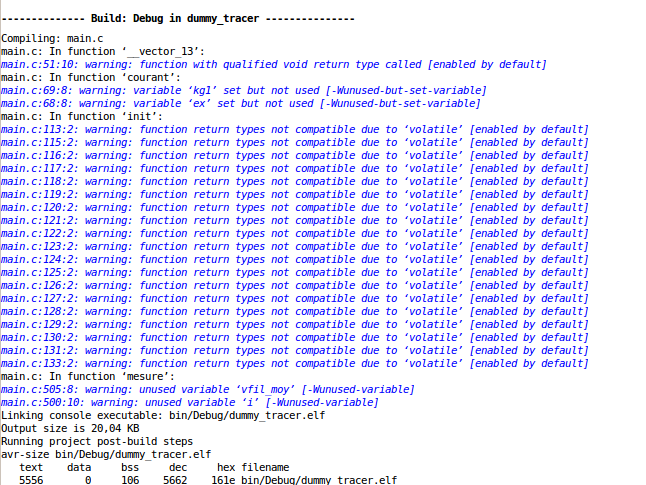

J'ai eu quelques soucis avec la lib math.h sous code:blocks, le compileur
avr gcc m'a sorti un bug
j'ai du supprimé 2 lignes avec isfinite ligne 340 et suivante du fichier math.h
pour que ça décoince , pas orthodoxe mais bon :oops:
Ci-joint une capture du debug log avec des warnings
tu en pense quoi :?:

base.c: In function '__vector_13':
base.c:49:10: warning: function with qualified void return type called
base.c: In function 'init':
base.c:116:2: warning: function return types not compatible due to 'volatile'
base.c:118:2: warning: function return types not compatible due to 'volatile'
base.c:119:2: warning: function return types not compatible due to 'volatile'
base.c:120:2: warning: function return types not compatible due to 'volatile'
base.c:121:2: warning: function return types not compatible due to 'volatile'
base.c:122:2: warning: function return types not compatible due to 'volatile'
base.c:123:2: warning: function return types not compatible due to 'volatile'
base.c:124:2: warning: function return types not compatible due to 'volatile'
base.c:125:2: warning: function return types not compatible due to 'volatile'
base.c:126:2: warning: function return types not compatible due to 'volatile'
base.c:127:2: warning: function return types not compatible due to 'volatile'
base.c:128:2: warning: function return types not compatible due to 'volatile'
base.c:129:2: warning: function return types not compatible due to 'volatile'
base.c:130:2: warning: function return types not compatible due to 'volatile'
base.c:131:2: warning: function return types not compatible due to 'volatile'
base.c:132:2: warning: function return types not compatible due to 'volatile'
base.c:133:2: warning: function return types not compatible due to 'volatile'
base.c:134:2: warning: function return types not compatible due to 'volatile'
base.c:136:2: warning: function return types not compatible due to 'volatile'
En fait, le compilo couine à cause du tableau de pointeur de fonction
que je déclare retourner un volatile void, ce qui est d'une stupidité verticale
de ma part !!! tub20
En virant le mot clef volatile dans le .h comme ci dessous, tout rentre dans l'ordre.
//tableau de pointeur de fonctions
void (*pf[ncom])(float);
Phil

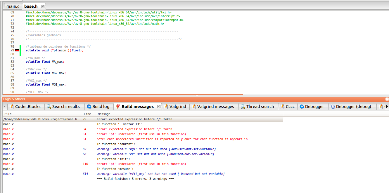

Je regarde le base.h et j'ai un message que j'arrive pas a résoudre
ci joint capture du debug
Si tu as une idée
MessagePosté: Dim 13 Jan 2013, 16:36
Messages: 198
Pour Totof
Oui, la ligne 79 du base.h contient
volatile void (*pf[ncom])(float);
Il faut la remplacer par
Maintenant, le compilo dit qu'il y a une erreur ligne 34 de base.c
A voir s'il n'y a pas une "faute de frappe" dans les lignes qui précèdent....
genre oubli d'un point virgule ou autre.....
Phil
(http://bidulic.free.fr)
